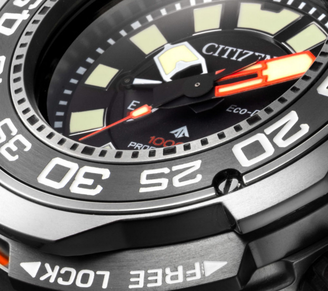

And how about that PROMASTER divers bezel! It is of course in line with ISO standard for a divers watch and has been designed to further eliminate the danger of its wearer accidentally turning the bezel the wrong way during a dive. So the Eco-Drive Professional Diver 1000m is equipped with a special bezel-locking mechanism.
When the bezel lock is set to FREE, an orange warning color is appears to alert the user. The crown also uses the same mechanism, revealing an orange color between the case and the crown to warn the wearer when the crown has not been correctly pushed into lock-mode.
