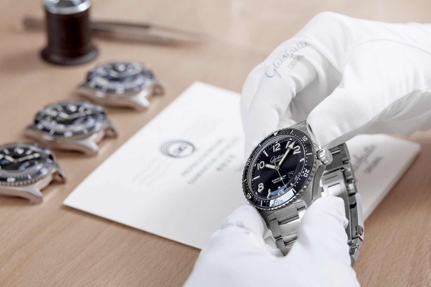

Each and every watch was tested and analyzed in-house for conformance with DIN 8306 and ISO 6425 standards in order to ensure the robustness of the individual functional elements.
During the process, each SeaQ watch is tested for water-resistance, air tightness at over and under-pressure, shock-resistance, resistance to salt-water corrosion among many other criteria.

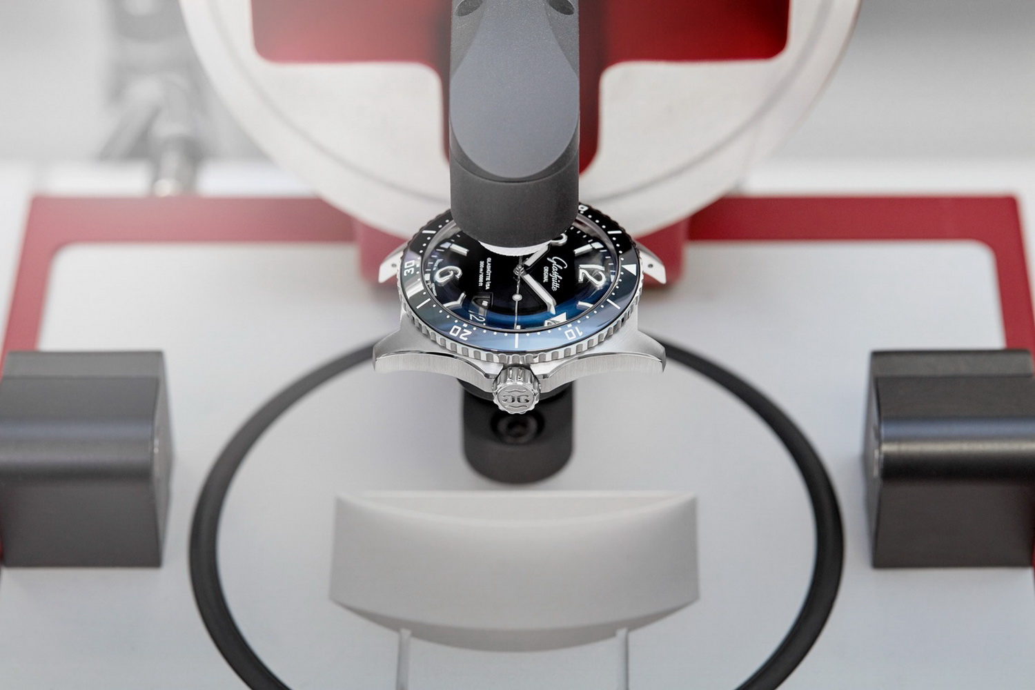

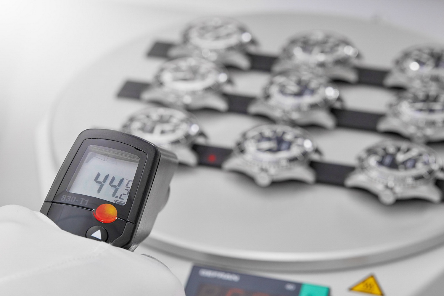

First up is the [Test for Moisture]. The SeaQ is first heated for 30 minutes to 40-45°C and then covered with a cold wet piece of felt.
If there is any moisture in the watch, it would appear at this point as condensed water on the inside surface of the glass.
If this is not the case, the watch is in conformance with the relevant standard and enters the testing phase.

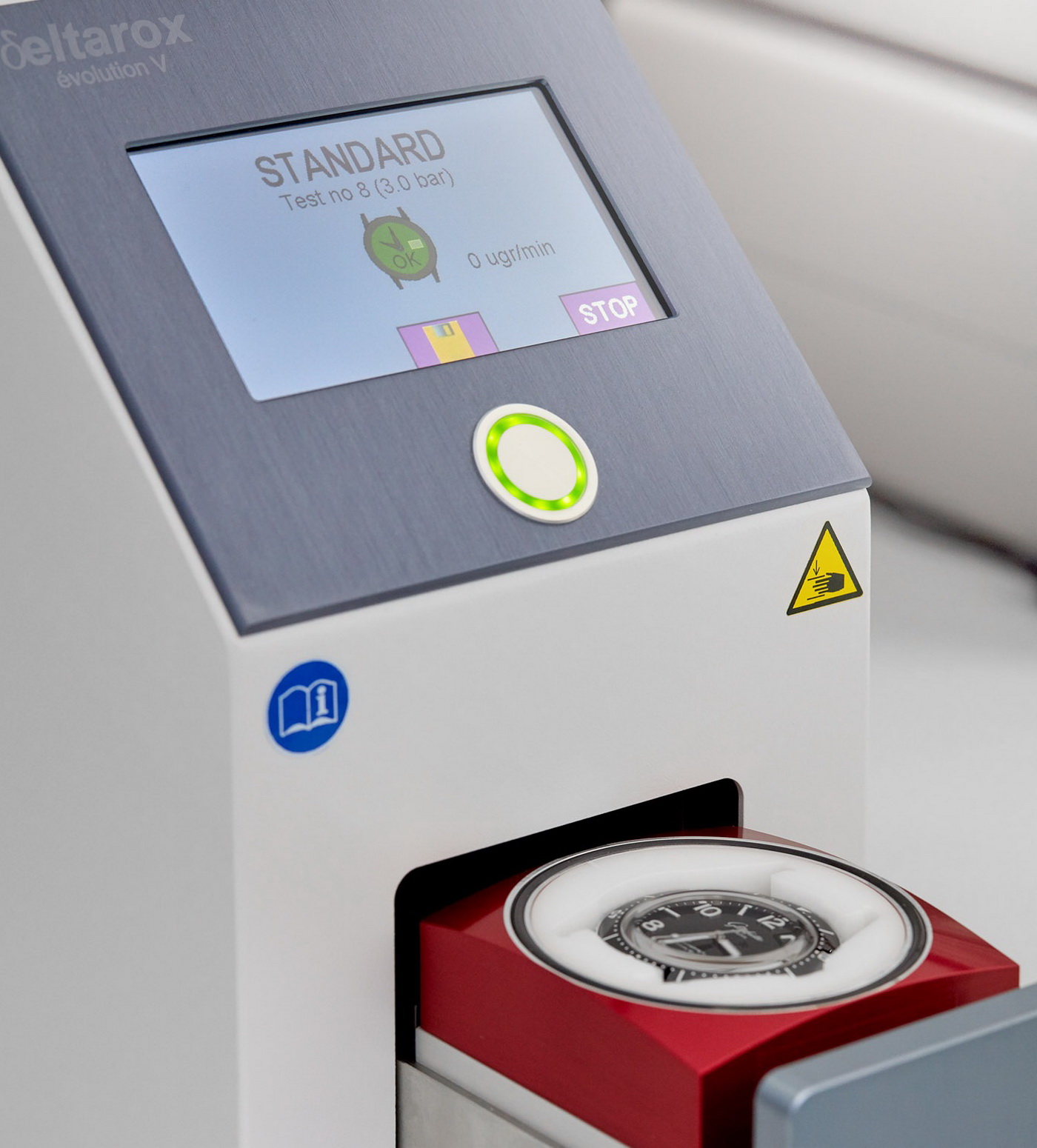

Next up is the [Determination of Resistance at Under and Overpressure]. The SeaQ is exposed to an under-pressure of -0.2 bar.
This simulates use of the watch at high altitudes (in the mountains or in an airplane). The watch is then exposed to an overpressure (as at great depths underwater) of 125%.
This corresponds with 20-bar watches to a value of 25 bar, and with 30-bar watches to a value of 37.5 bar.

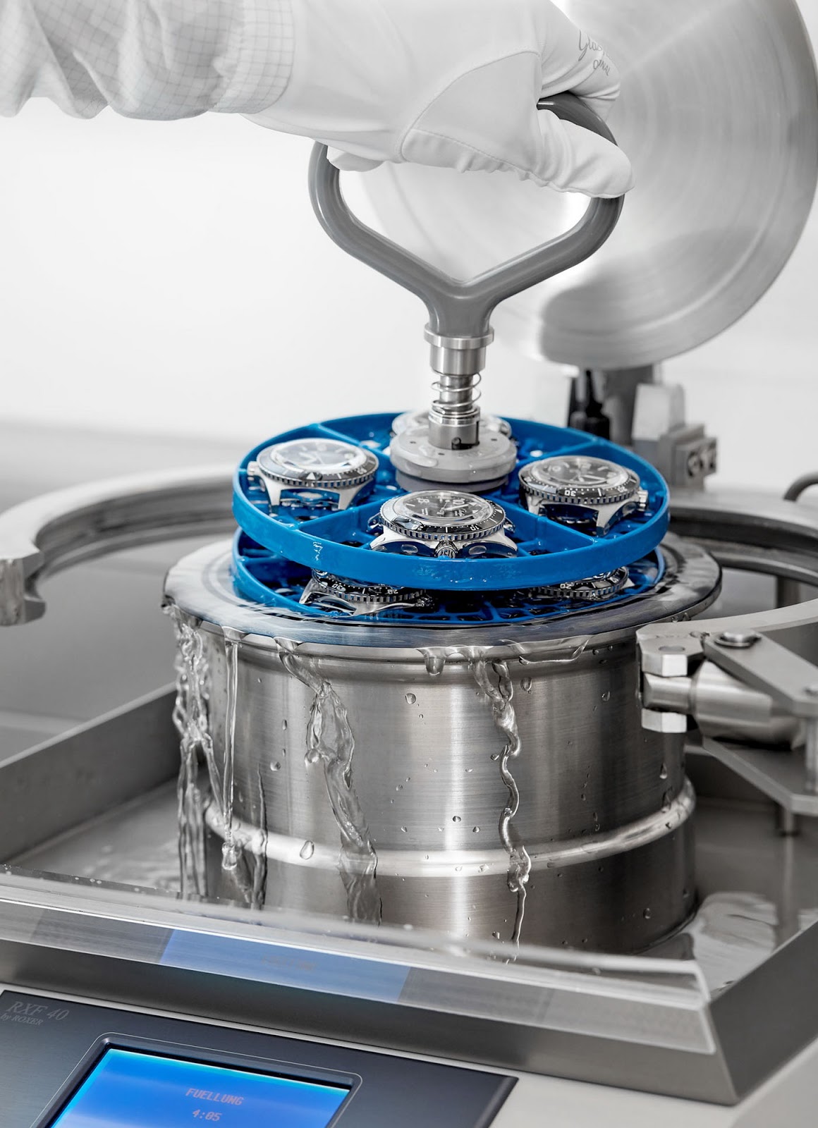

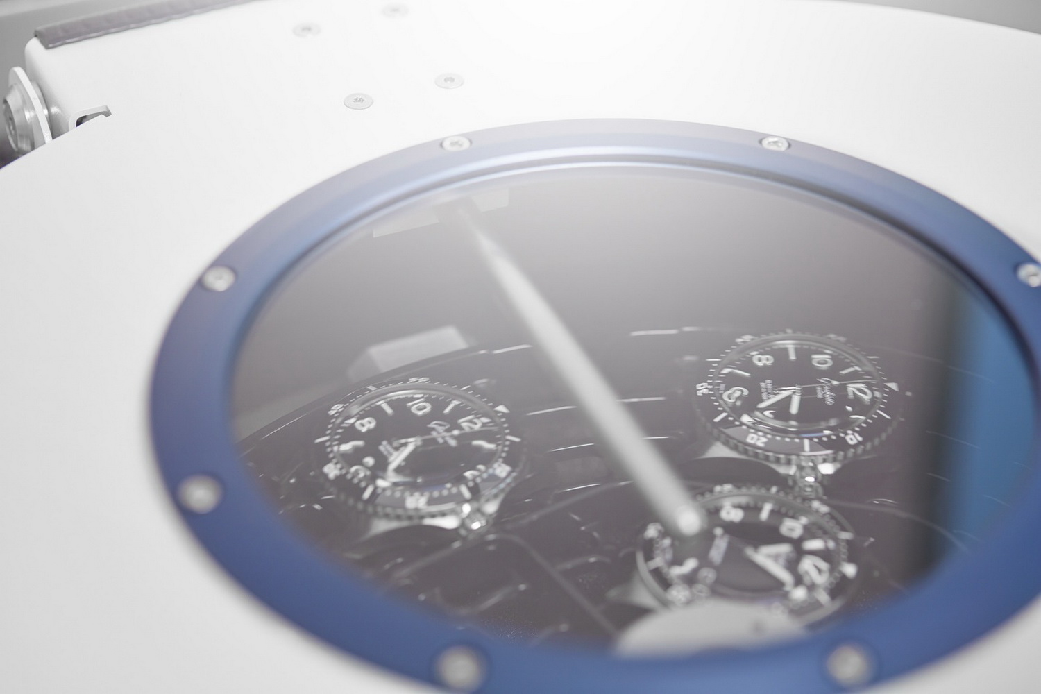

Now for the [Water-Resistance Test and External Drying]. The first phase includes the watch being exposed in distilled water to an overpressure of 125%.
This overpressure is maintained for a certain period of time. In a second phase the pressure is then lowered to a slight overpressure of 0.3 bar.
Following the water resistance test in a water bath, the outside of the SeaQ is dried by rotating the watch under a curtain of air.
This ensures that no moisture remains on the watch before it undergoes the final condensation test.

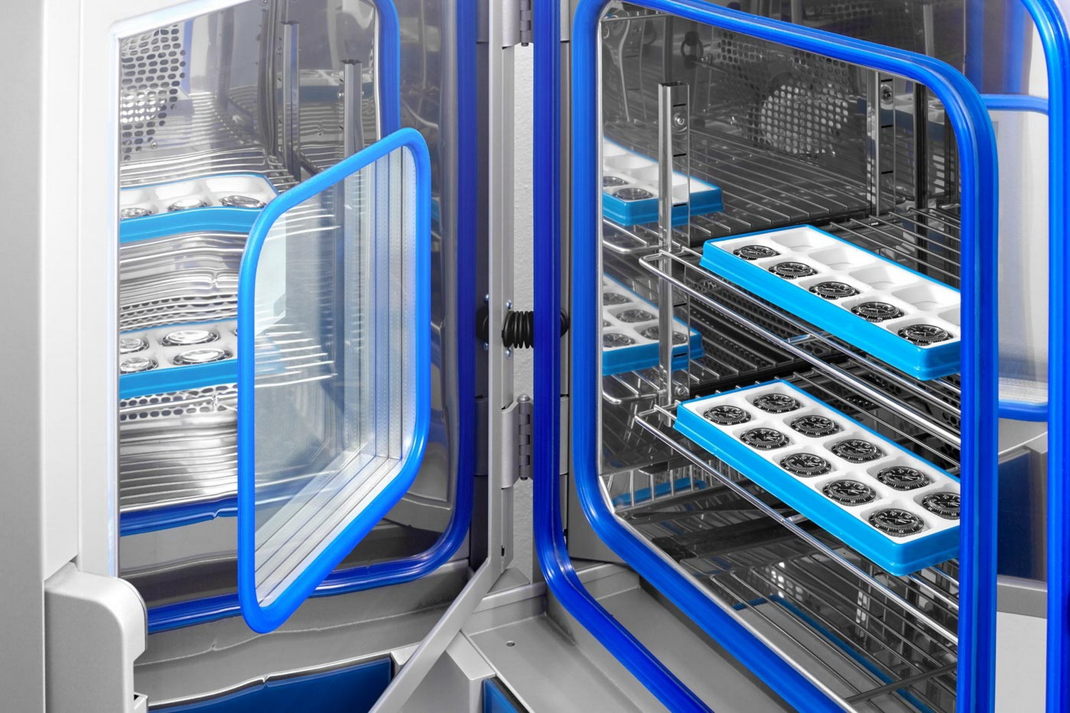

Finally a [Test for Moisture After Testing]. In this final step, the SeaQ is once again heated for 30 minutes to 40-45°C.
Afterwards a wet piece of felt is once again placed for one minute upon the upper surface of the glass.
If no condensation appears on the inner surface of the glass, bingo - the watch has successfully passed the test series without having being breach by any water.

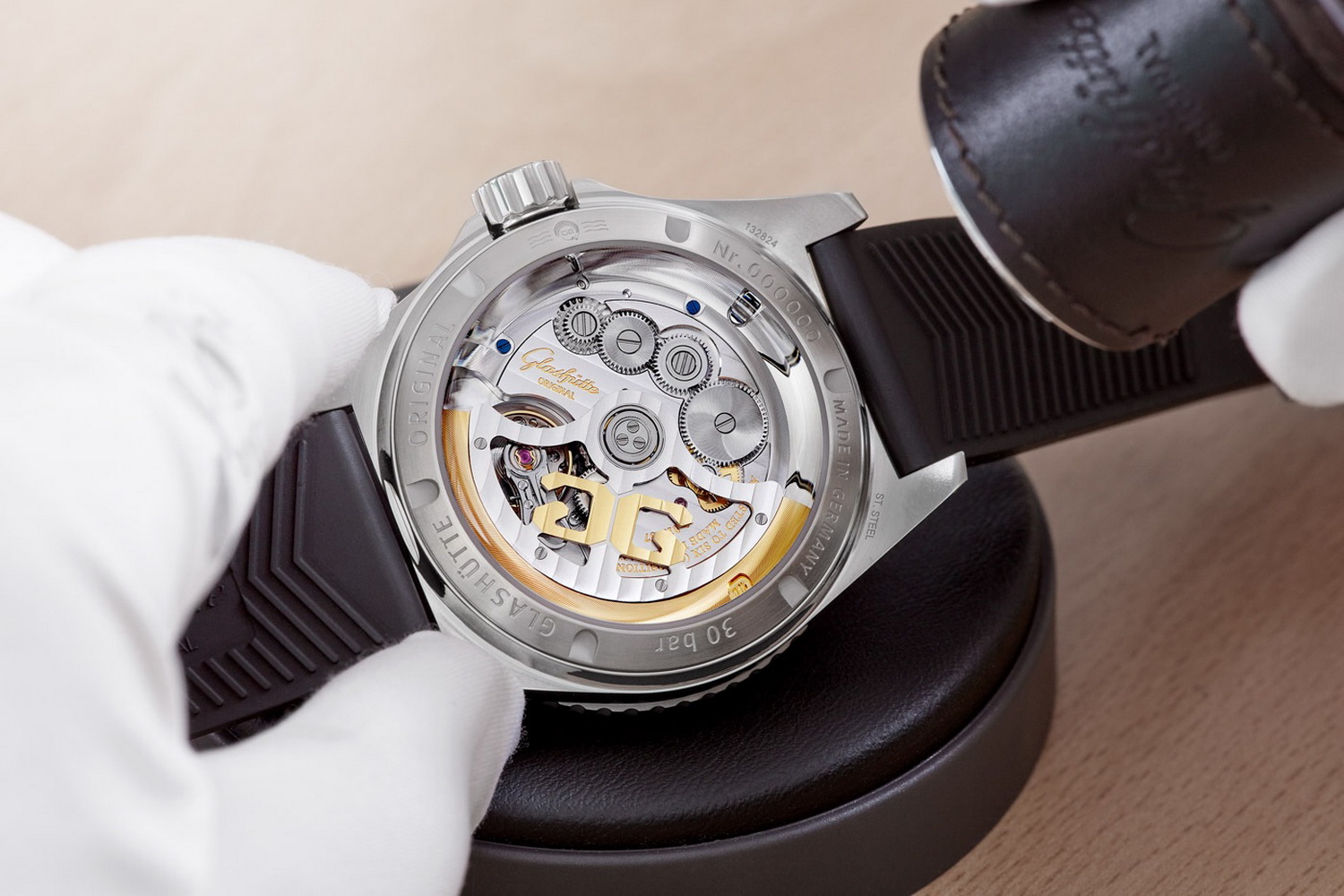

Lastly [The 24-day Test]. Not only does the SeaQ meet the stringent DIN and ISO standards for diver's watches, but it must also undergo the same demanding in-house 24-day test of any GO.
After successful completion of the test, each SeaQ gets an individual certificate document.
