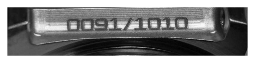

As a testament to this outstanding level of pressure-resistance, all 10 MILES watches bare a discreet ‘’25300M CERTIFIED’’ engraved hallmark between their lugs.

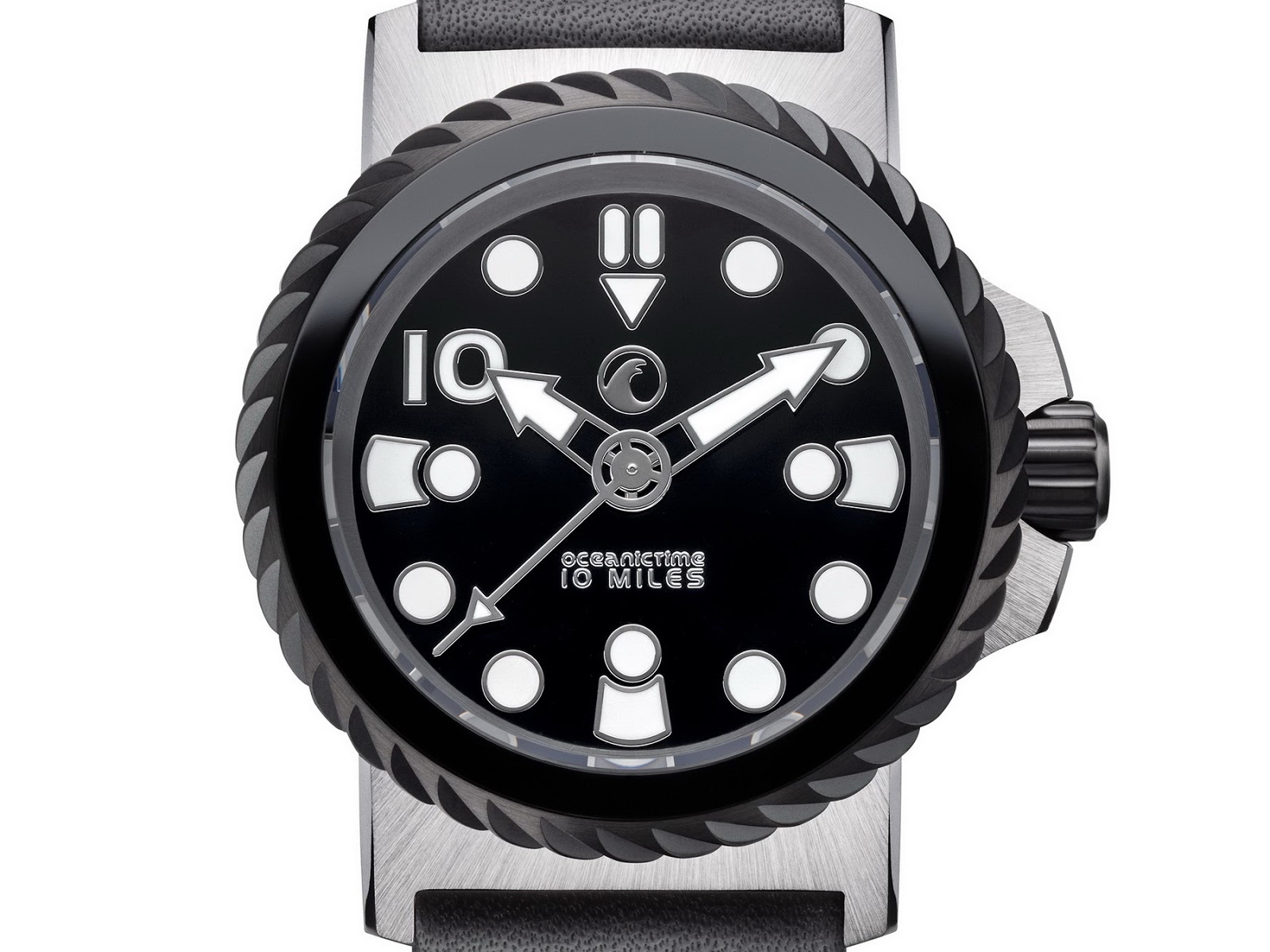

DIAL Offered in three dazzling sunburst finishes: dark anthracite, deep black and abyss blue (an OceanicTime first), the dial of the 10 MILES has been designed for optimum legibility; both date aperture and minute track are noticeably absent.
Instead large professional-style appliqué indexes with chrome surrounds dominate the dial, an H2O signature, disrupted only by the presence of a single Arabic numeral, the ‘’10’’ whose presence is more than a simple quirk.
A specific design feature, the “10” not only relates to the 10 MILES name but once again to our 10thAnniversary. Matching the chromed indexes are a set of chromed arrow-head hands along with the H2O Watch and OCEANICTIME logos as well as the ‘’10 MILES’’ name / water-resistance text.
All hands and dial markers of the 10 MILES watch have been generously filled with Swiss Super-LumiNova® BGW9 which emits a bright blue light.
MOVEMENT What makes the 10 MILES so extraordinary is that locked within its hermetically sealed vault-like case, it houses a Swiss made, self-winding mechanical movement. This is no oil-filled, quartz-powered, pretender, folks – this has air inside it!
Powering the 10 MILES is a Swiss made ETA 2892 TOP GRADE automatic movement with; blued screws and custom perlage on its rotor. Each watch is individually regulated by H2O’s German watchmaker for increased accuracy and precision.
Its functions include: hours, minutes and sweep and hacking seconds.

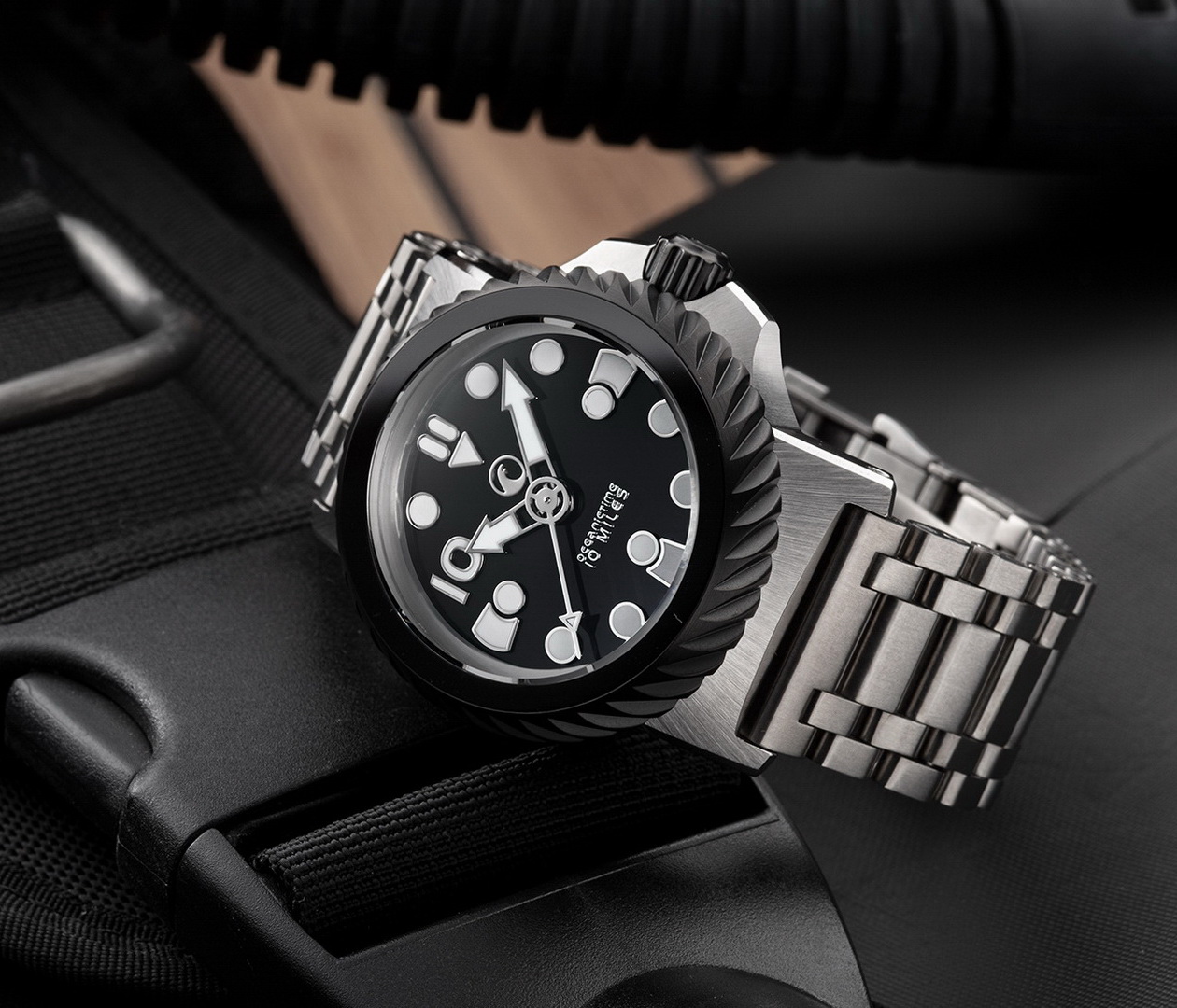

DEEP BLACK In addition to the regular 10 MILES watch, a special DEEP BLACK edition presented in a classic OceanicTime monochromatic livery is also available. For the DEEP BLACK edition, a high-quality German DLC (diamond like carbon) surface treatment has been applied to the 10 MILES’s; bezel, crown and case-back offering additional scratch-resistance along with classic OceanicTime contrasting case components.

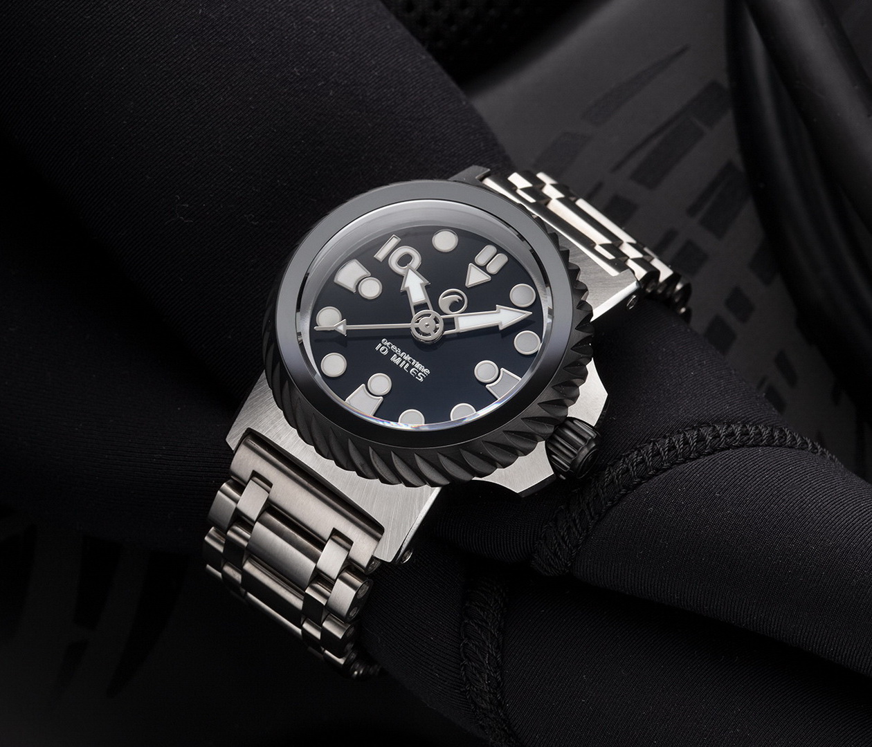

The 10 MILES & 10 MILES DEEP BLACK are both available now from H2O WATCH.
