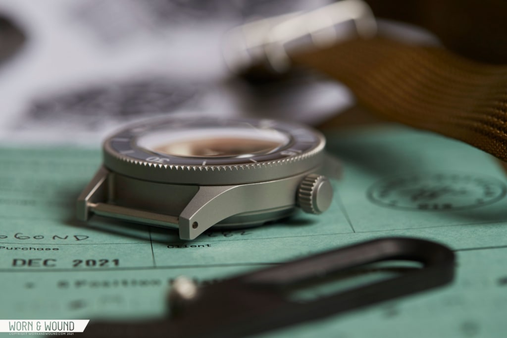

Starting with the case, at 40mm x 48.5mm x 14.7mm (including the gently domed crystal), it’s nicely sized, tough, stout, and a bit smaller, I believe, than the TR-900. Smaller. What a world we live in. The 48.5mm lug-to-lug goes a long way towards making it fit the wrist well, and helps balance a fairly thick profile. An interesting note here – one of the elements that got a full reconsideration was the case-back, which is a piece of solid steel that screws in via tool grips and has been given a gentle dome. This is Bill Yao adding some of his experience and design philosophies into the mix. The dome comes at the cost of increased thickness on paper, but is meant to add comfort, and lets the watch sit “in” the wrist a bit more, thus riding lower in action.
Another Bill addition can be found in the crown construction. A quick search for TR-900 images will show you that they didn’t feature seemingly very substantial crowns. They look quite diminutive in fact and exposed to the elements. For the TR-660, they went the tanky route, and I’m all for it. Measuring 7mm in diameter, it protrudes up to 4.25mm from the case but is actually sunken into the case as well. A portion of the crown screws into a recess in the mid-case, providing additional strength and protection. In other words, it’s a very robust crown.
The case is evenly bead-blasted all around for a no-fuss, but appealing finish. A brushed version would be welcome as well for those who want a less utilitarian look. It isn’t military issued anymore, after all. The lugs are drilled, and the lug width has been bumped up to 20mm from 19mm. Both of these are good calls for a commercial watch. Fixed bars are a pain (sorry Tudor), and 20mm straps are far more available. I also think the slightly wider strap adds to the overall athletic feel of the watch. One cool detail here is that the watch comes with two sets of spring bars, one “fat” shoulderless pair at 2.5mm thick, and one standard set at 1.8mm. The idea is that for pass-through straps, one would use the thicker bars, which provide a more robust platform (and won’t stretch out leather straps).
What I like about the TR-660 is also what I would criticize. It’s a severe design. The sides are flat and meet flush with the cylindrical bezel which ends with a 90-degree angle into a flat bezel. There are no bevels and the curves of the lugs almost seem like a begrudged addition because straight lugs just would have been dangerous. It’s a tool watch that’s more tool than watch.
That’s part of its charm, its look, but it also anchors it in the past. While the TR-660 isn’t meant to pass as a vintage watch, it’s not fully modernized either. It’s sort of an in-between step for the Tornek-Rayville as they bring the brand up to the future (this is my assumption, at least). Perhaps no element better shows this than the acrylic bezel insert. While an aluminum option was available, the acrylic provides a bakelite-esque charm, perhaps leaving the decision of modern vs vintage up to the customer. This is highlighted even further by being adjacent to the double domed sapphire crystal, which while likely the best choice for the watch, isn’t as accurate as an acrylic dome would have been. For the record, I like the sapphire they went with as it is optically clear from edge to edge giving a full view of the dial.
And with that said, it is simply one of the best executed bezel inserts of this type I have come across. Though simple, featuring the same reduced series of markings with numerals at 15, 30, and 45 found on the TR-900, the depth is remarkable. At an angle, you can see the sides of the lume-filled engraved regions, which adds a cool 3D effect. It also glows very well.
Regardless of the insert, the bezel features a 120-click mechanism with a decidedly smooth feel. Where some bezels feel like they pop into place, this feels more like it slides in. That’s not a knock either, in fact, I find it quite pleasant, but it’s not designed to be the loudest, poppiest bezel. Functionally, it seemed to work well in a non-dive setting. It takes just enough effort to push, and lines up with just a hint of back play.
